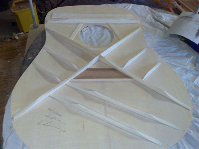

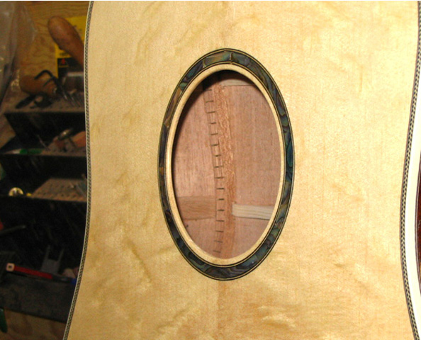

Braced top - the finger braces are sort of parabolic. the intention here is to keep mass in the centre of the soundboard. There's also a little "Mario" brace behind the bridge plate.

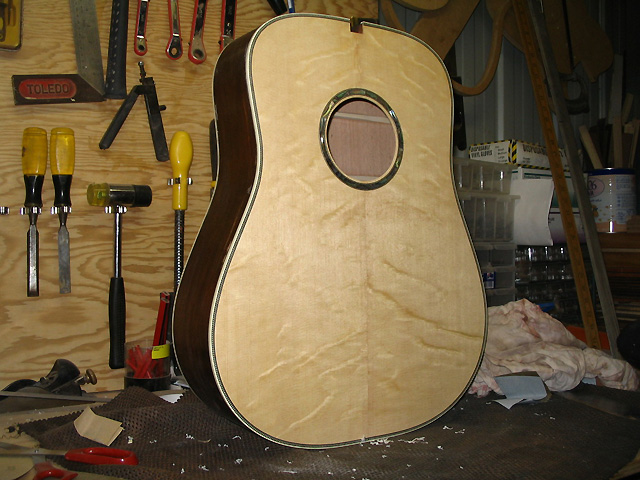

Le top avec paua rosette - bearclaw sitka
Le rosette

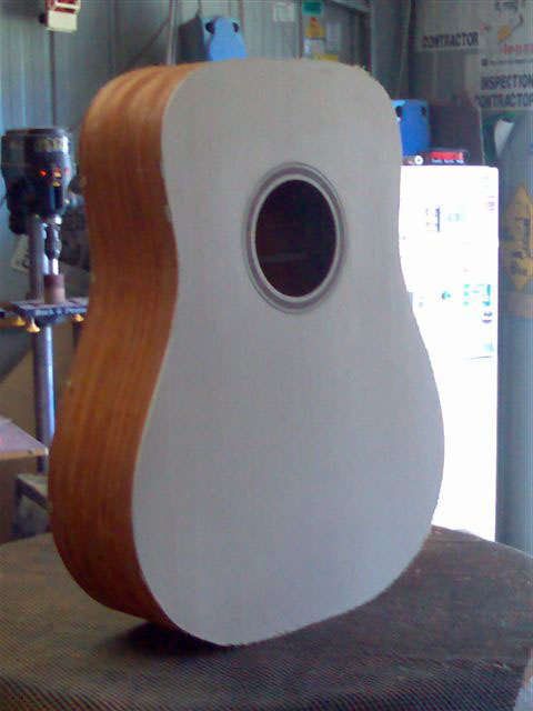

The Padauk Dread
- this one is a bit of an experiment. The top is very thin (.083") and don't even ask what the black laminations in the neck are
We strung this up before finishing it and it sounds great. Very loud with a tight bottom end and rich through the mids.(it makes my D18 sound a bit flat)

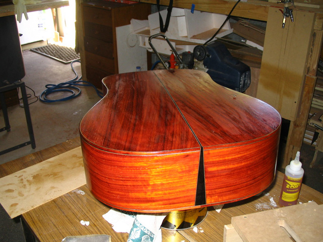

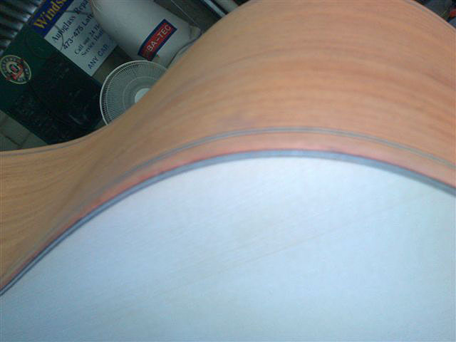

Body with Z-poxy

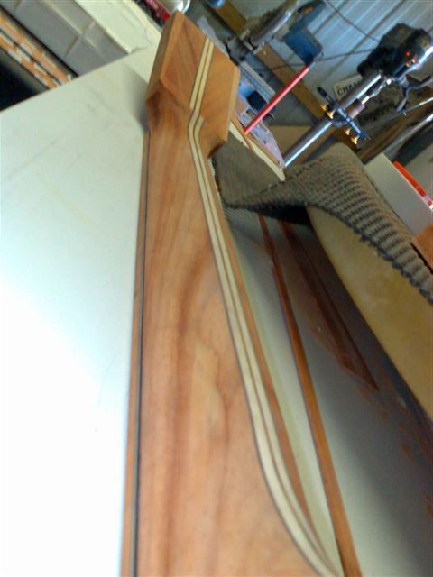

Padauk neck

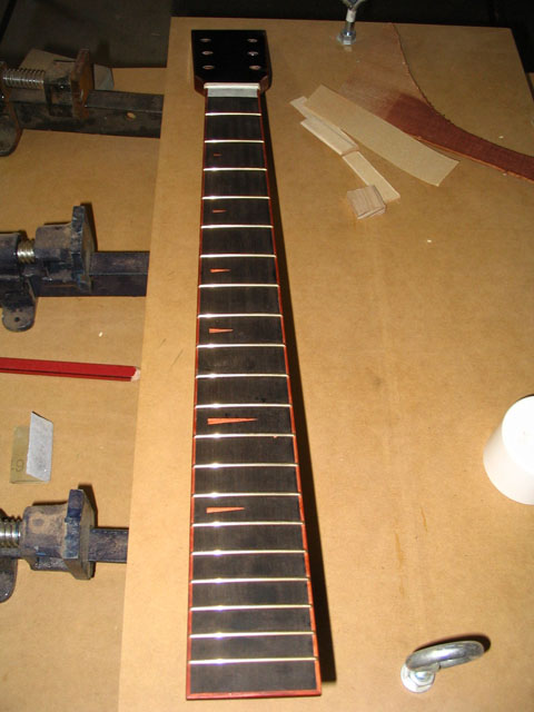

Fingerboard - with Padauk bindings and inlays of course.
You can't see it in the photo but the fretwire is that gold stuff from LMI. Looks super with the Padauk bindings.

The Bearclaw came from Brent Cole at Alaska Specialty Woods. It's an AAA top and is very stiff. We got some Master grade from him as well and that stuff is just gorgeous.
Steve, we were initially concerned about bending the Padauk after reading about others experience with it, but it caused us no problems. Thinned it down to .085, ran it under the garden tap for a few minutes, wrapped it in foil and cooked it on the Fox Bender at 300. The bindings got the same treatment with no cracking
